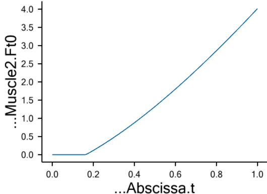

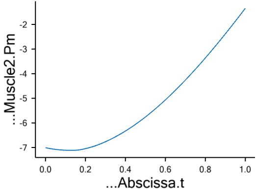

The key to understanding the muscle’s behavior is to study the forces in the muscle’s different elements. The chart of Fm, which is the force in the muscle’s contractile element, is very uninteresting. This muscle does not contribute to carrying the load, and hence the system does not activate it. But the muscle is not without force. The property Fp, which is the force in the parallel-elastic element of the muscle has the following behavior:
In the initial phase of the movement, the parallel-elastic element is slack and adds no force to the muscle. But as the muscle gets extended, the passive muscle force sets in, and it continues to rise as the movement progresses. Notice that this passive force acts against the movement and hence requires Muscle1 to work that much more. But the passive force has another interesting effect, which we can see if we chart the property Lt, i.e. the length of the tendon (Notice that we have changed the scale of the ordinate axis):
From the time the passive force sets in, the tendon starts to elongate a little bit.

The hypothetical force that the tendon would have if the activity of the muscle were zero. The reason why this is slightly different from Fp is that Ft0 acts directly along the action line of the muscle while Fp is diverted by the pennation angle. This property is mostly interesting to scientists involved in detailed modeling of single muscles. |
The gradient of Ft0 with respect to the muscle activity. For mathematical reasons this is equal to the Strength, and the two graphs are identical. The reason why this property is included under to different names is that the simple muscle model, from which this model is derived, does not have Ft0Grad and hence needs a Strength property. |

The mechanical power of the contractile element. |
The mechanical power of the entire muscle-tendon unit, i.e. the rate of work performed on the skeleton. Notice that the power is negative because the muscle is extending against the force. Muscles behaving like this in the human body are often termed antagonistic muscles. |
