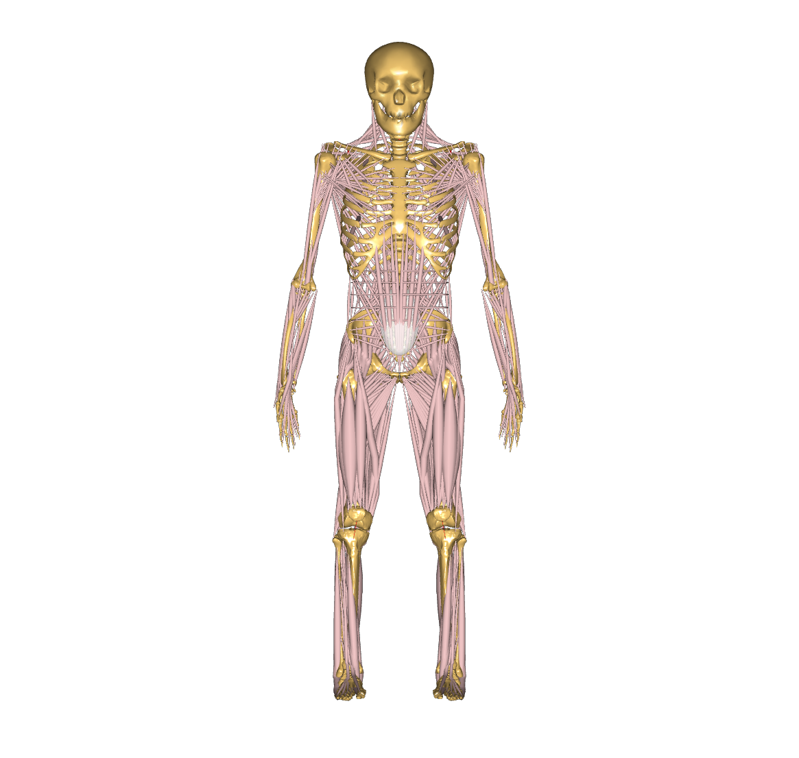

When loading the model, you will now see the Human Model in the Model View.
