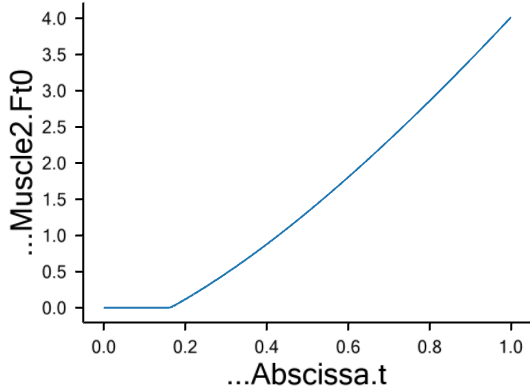

The key to understanding the muscle’s behavior is to study the forces in the muscle’s different elements. The chart of Fm, which is the force in the muscle’s contractile element, is very uninteresting. This muscle does not contribute to carrying the load, and hence the system does not activate it. But the muscle is not without force. The property Fp, which is the force in the parallel-elastic element of the muscle has the following behavior:
Force parallel elastic element
In the initial phase of the movement, the parallel-elastic element is slack and adds no force to the muscle. But as the muscle gets extended, the passive muscle force sets in, and it continues to rise as the movement progresses. Notice that this passive force acts against the movement and hence requires Muscle1 to work that much more. But the passive force has another interesting effect, which we can see if we chart the property Lt, i.e. the length of the tendon (Notice that we have changed the scale of the ordinate axis):
Tendon length plot
From the time the passive force sets in, the tendon starts to elongate a little bit.

We seem to be faced with a circular dependency between the muscle properties. The three-element model copes with this through a one-time correction: It recruits the muscle without taking the tendon elongation into account. Then it computes the tendon elongation. Finally, it computes the influence of the elongation on the muscle’s strength and corrects the muscle activity to the level that provides the necessary force with the modified strength. This is only an approximative solution because the change of muscle strength may theoretically alter the distribution of force between the muscles, and this alteration is not done by the system; the correction is local to each muscle.
So much for passive properties! It is more instructive to investigate a muscle model with active force. The easiest way to do so is to enable our hand force again and change it to point directly upward. This causes the previously inactive Muscle2 to become active:

Ft0
The hypothetical force that the tendon would have if the activity of the muscle were zero. The reason why this is slightly different from Fp is that Ft0 acts directly along the action line of the muscle while Fp is diverted by the pennation angle. This property is mostly interesting to scientists involved in detailed modeling of single muscles.
Ft0Grad
The gradient of Ft0 with respect to the muscle activity. For mathematical reasons this is equal to the Strength, and the two graphs are identical. The reason why this property is included under to different names is that the simple muscle model, from which this model is derived, does not have Ft0Grad and hence needs a Strength property.
