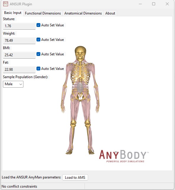

To change the scaling of the model you can start the plugin by clicking the ANSUR Configuration from the tools line:
ANSUR Plugin toolbar icon
This will bring up the plugin window:
ANSUR Plugin window
The plugin has 4 tabs:
  • Basic Input: This tab allows you to overwrite Stature, Weight, BMI, Fat percentage and select gender.
  • Functional Dimensions: This tab allows you to select a functional dimension from a drop down list. It will display a image of the dimension applied to the model and allow you to enter a value for the dimension or select if the plugin should calculate the value based on the other dimensions.
  • Anatomical Dimensions: This tab allows you to select a anatomical dimension based on the available dimensions of the model. It will display a image of the dimension applied to the model and allow you to enter a value for the dimension or select if the plugin should calculate the value based on the other dimensions.
  • About: This tab contains information about the plugin.
At the bottom of the window you can see the Load to AMS button. This button will write the selected dimensions to the file AnyMan_ANSUR.any and load the model.
