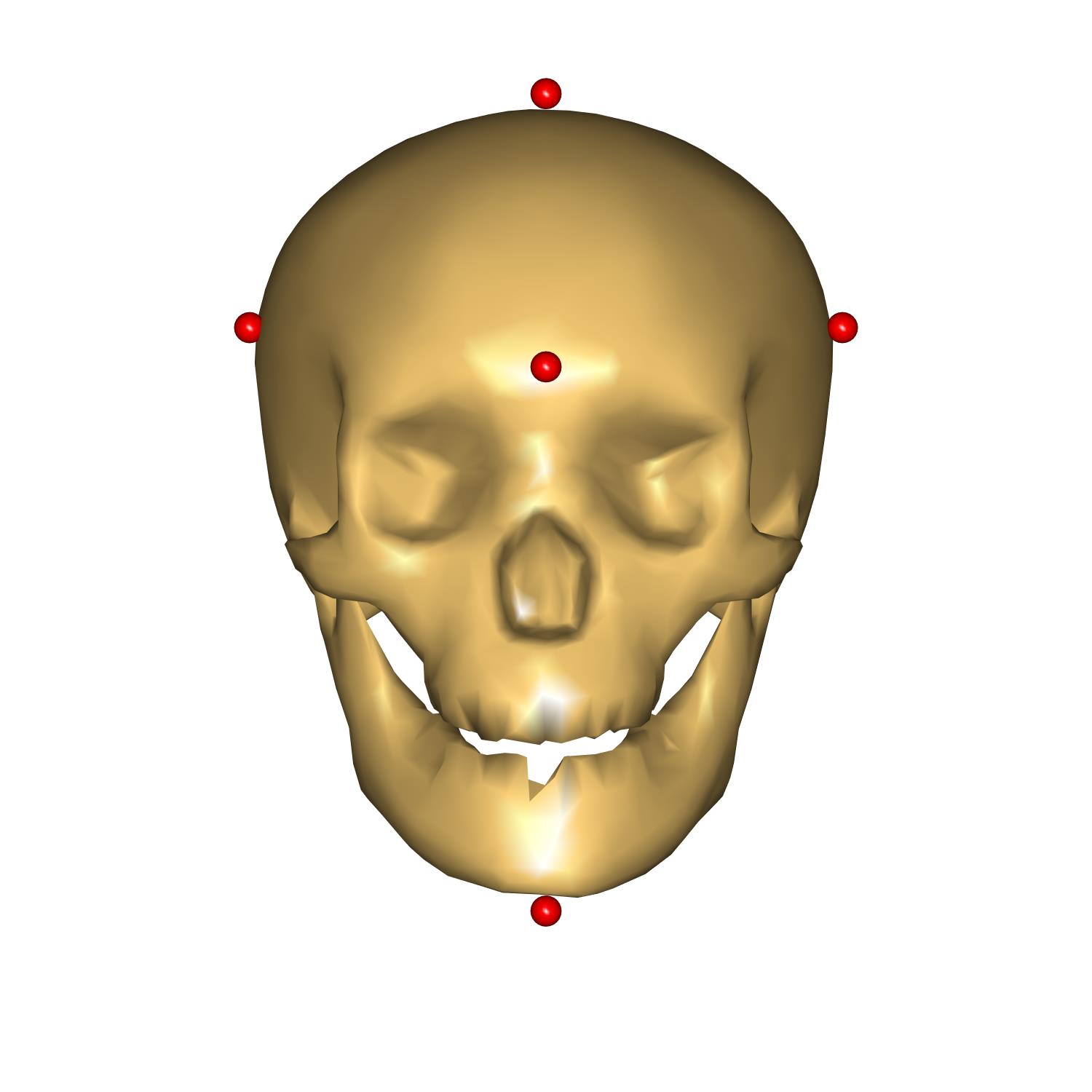

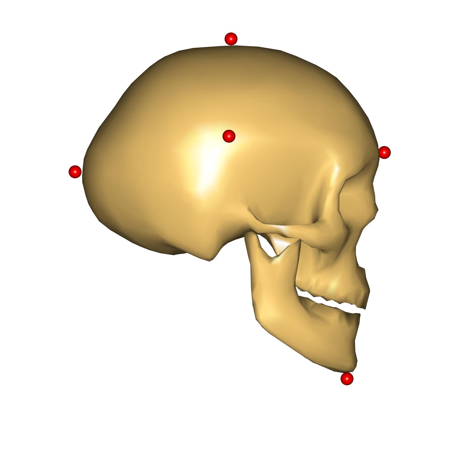

We have prepared some code to visualize points used to measure these distances. As well as that a couple of measures were added to see the result of scaling. Please enable this code by uncommenting the following code:
// Head scaling visualization and measurements
#define HEAD_SCALING_XYZ
#ifdef HEAD_SCALING_XYZ
  #include "Model\HeadScalingXYZ.any"
#endif
Head Markers Front View Head Markers Lateral View

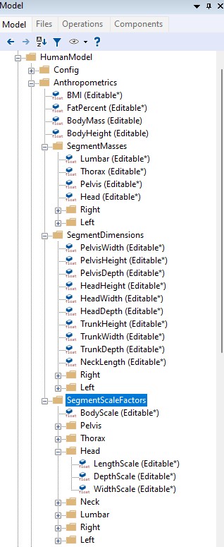

Let us inspect what segment dimension are available for this scaling law. Go to Main.HumanModel.Anthropometrics.SegmentDimensions in the model tree:
XYZ segment dimensions
We could see that the first section containing overall body parameters and the SegmentMasses folder are identical to any other scaling law. But instead of only having a folder called SegmentDimensions, we now have another called SegmentScaleFactors. Looking at the content it is clear that this folder contains invidual scaling factors along main axes. By default all values are set to be 1, meaning that the cadaveric data will not scale and the law will behave similarly to the _SCALING_NONE_.

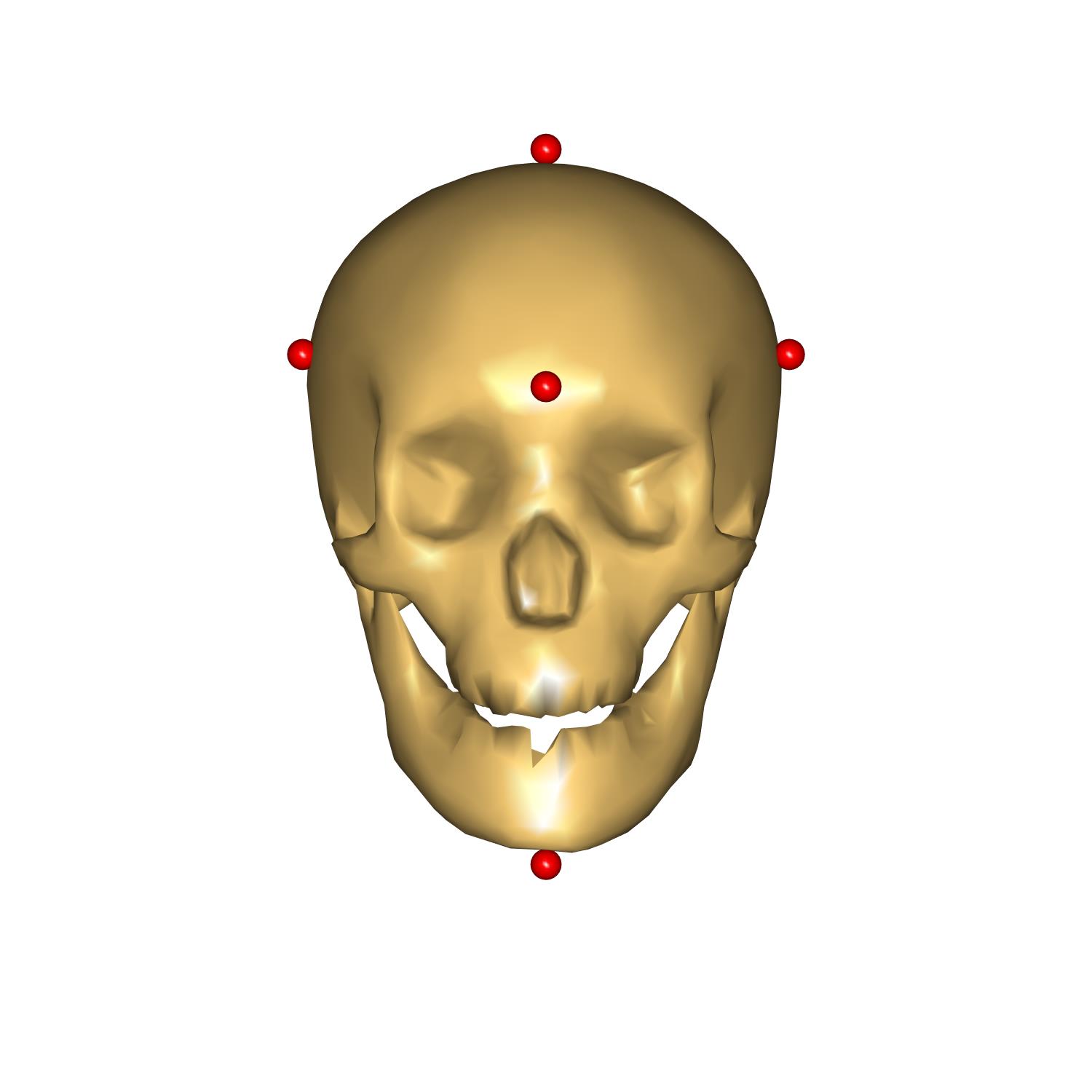

Now that we know original and desired dimensions the scale factors can be defined as the following block of code inside the AnyManXYZ.any. Please apply this changes and reload the model:
Main.HumanModel.Anthropometrics.SegmentScaleFactors.Head = {
  // Standard unscaled values
  AnyVar HEAD_BREADTH = 0.19;
  AnyVar HEAD_LENGTH  = 0.239;
  AnyVar HEAD_HEIGHT  = 0.26;
  // Scale factor computation
  LengthScale = 0.228/HEAD_HEIGHT;///< 228mm, DIN 1986
  DepthScale = 0.193/HEAD_LENGTH; ///< 193mm, DIN 1986
  WidthScale = 0.156/HEAD_BREADTH;///< 156mm, DIN 1986
../_images/HeadMarkersFrontView.jpg ../_images/HeadMarkersAppliedFrontView.jpg

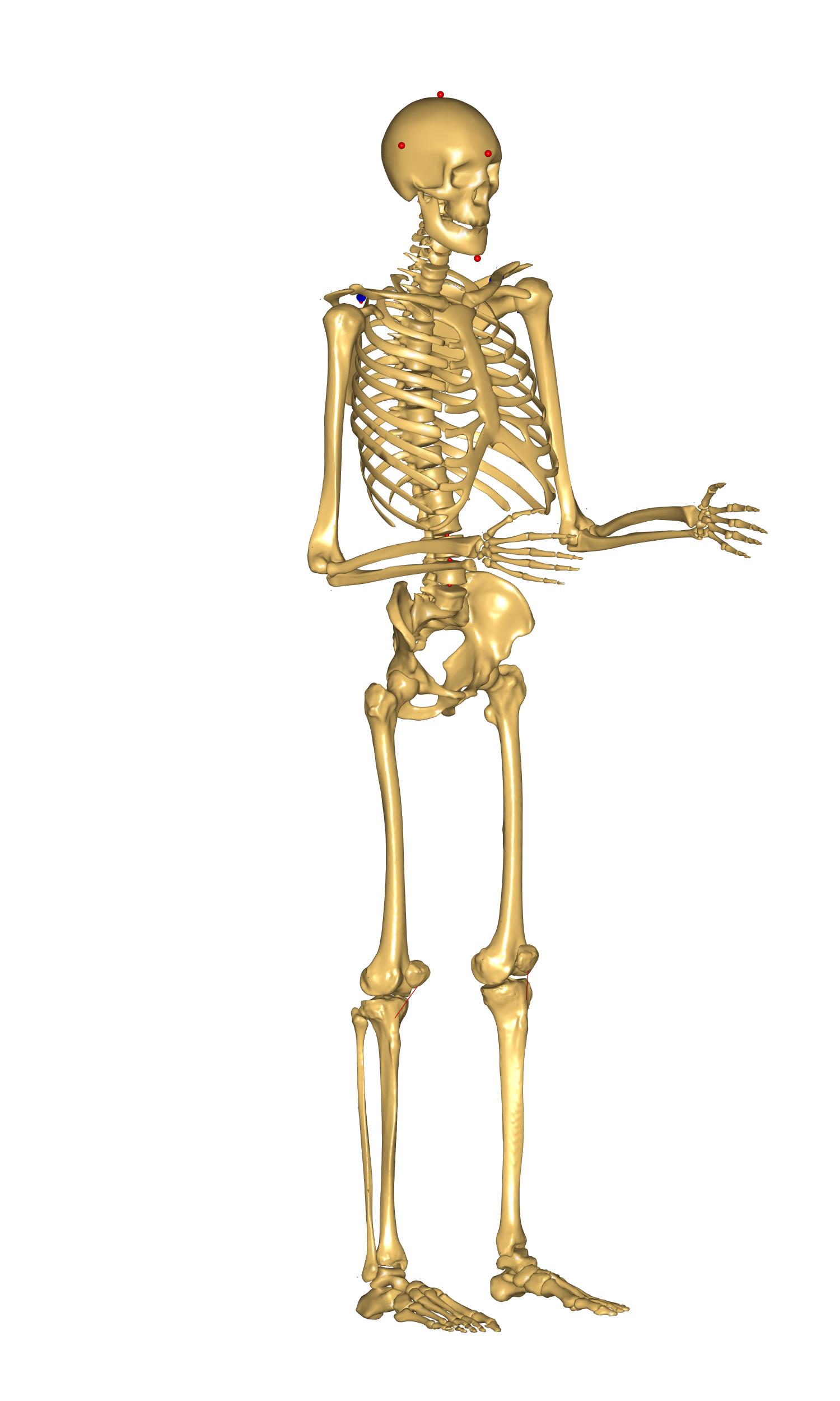

We have succesfully personalized our model to have a head that corresponds to the German 50th percentile man. We can see that it is slightly smaller than the default one coming with model. However, we still see that the body does not match the head size. The same anthropometric dataset suggests that the height of the 50th percentile man should be 173.3mm. We could mimic _SCALING_UNIFORM_ by defining a common scaling factor and applying it to all dimensions like this:
Main.HumanModel.Anthropometrics.BodyMass = 75 ;
Main.HumanModel.Anthropometrics.BodyHeight = 180 /100;
#define STATURE_SCALE_FACTOR 1.733/1.75
Main.HumanModel.Anthropometrics.SegmentScaleFactors.Pelvis = {
  LengthScale = STATURE_SCALE_FACTOR;
  DepthScale = STATURE_SCALE_FACTOR;
  WidthScale = STATURE_SCALE_FACTOR;
Main.HumanModel.Anthropometrics.SegmentScaleFactors.Thorax = {
Scaling XYZ Final
By applying these changes we complete this tutorial. Our model looks more natural and corresponds to the 50th percentile German male as suggested by DIN in 1986.
