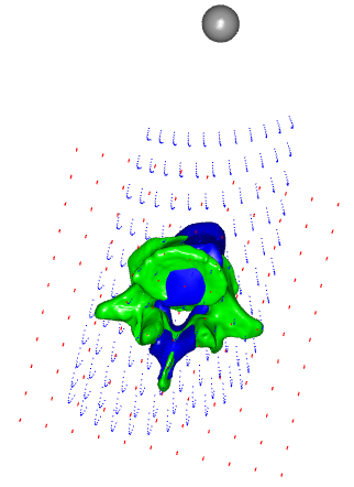

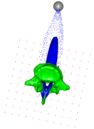

0.2 ../_images/image234.png
2 ../_images/image334.png
20 ../_images/image422.png
200 ../_images/image519.png
We can see strange behaviour of the deformation field that is hard to explain, however, you can notice that the deformed grid is approaching the origin of the coordinate system, when the parameter increases. Let us look back at the definition of the Gaussian radial basis function: \(\phi\left( r \right) = e^{- \text{ar}^{2}}\). We can see that the exponential nature will decrease the influence of the r component. However, if the parameter is too large the influence of radial distances will be minor and insignificant. Thus, it is necessary to keep the balance between this parameter and expected size of the object being scaled.

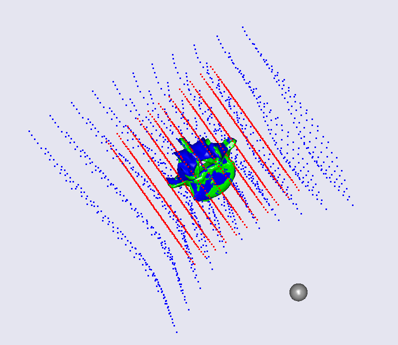

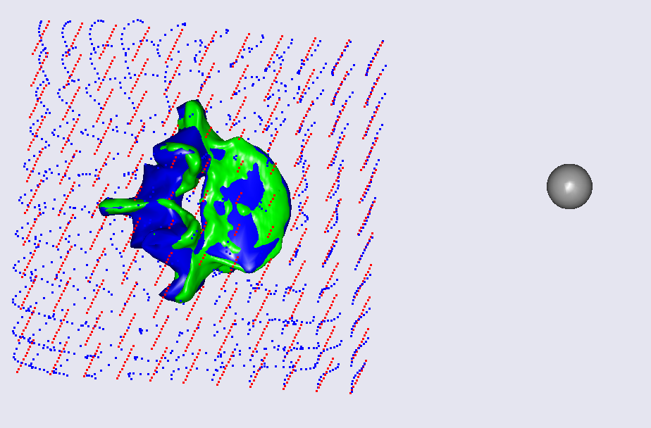

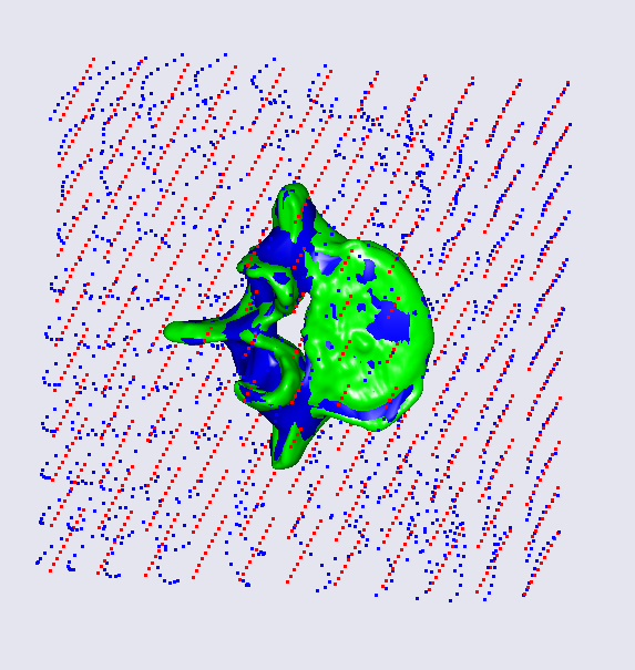

Param 0.2 and many landmarks
Now we see that the scaling does not work at all. The problem here is that the Gaussian type of the RBF transform is sensitive to the number of landmarks, and does not work well with a too large number of them. The solution here is to switch RBFDef.Type to RBF_ThinPlate:
AnyFunTransform3DRBF RBFTransform = {
  PreTransforms = {};
  RBFDef = {
    Type = RBF_ThinPlate;
    Param = 0.2;

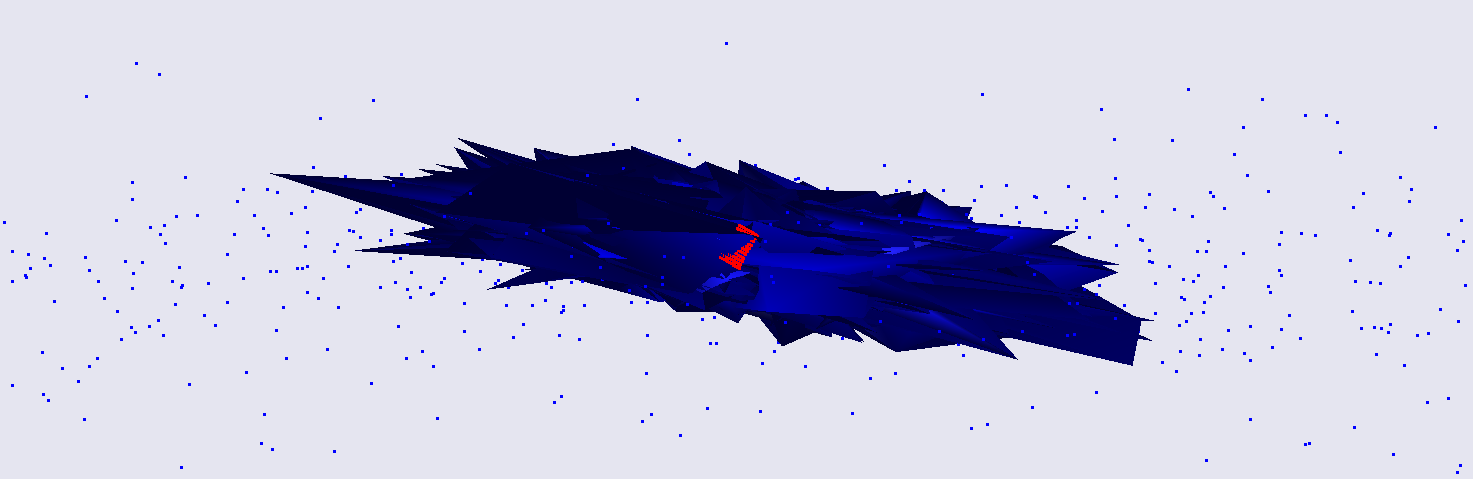

Param 0.2 and RBF_ThinPlate
This modification fixes the problem for the bony surfaces and their vicinities – now they look alike. Thus, it is recommended to use RBF_Gaussian type only with low number of landmarks. RBF_ThinPlate is recommended for larger numbers. However, you may also choose between RBF_ThinPlate and RBF_Gaussian based on their performance.

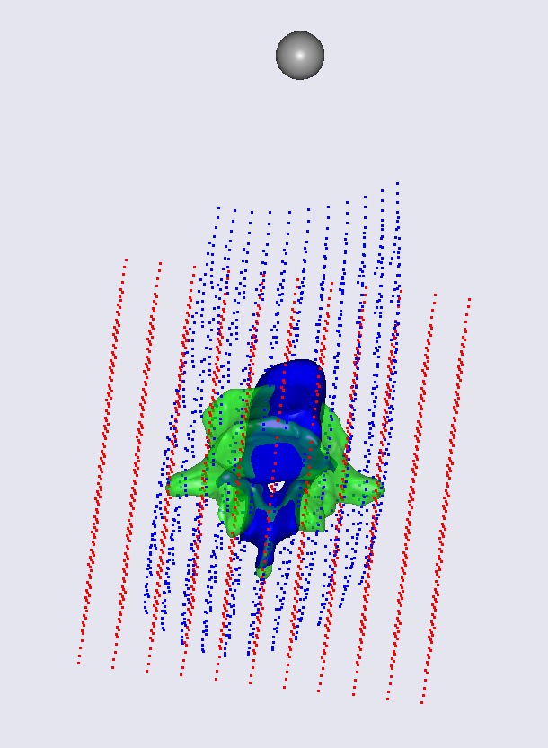

PolynomDegree 1
However, one may still think that the extrapolated points are lying too far out. There is one more modification that may affect this solution. We can define the behavior of the extrapolation by suggesting the boundaries of the transform. The bounding box member enables us to take its points as both source and target landmarks making a candidate point for extrapolation to be transformed into itself. Let us try to switch on the bounding box corners and face points to be included as landmarks:
